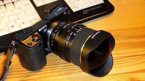

Samyang = WalimexPro 14mm/2.8
http://www.foto-tip.pl/sklep/samyang...ny-p-1566.html
http://www.foto-walser.biz/shop/Arti...nolta_Sony.htm
kleiner, leichter Samyang 8mm/3.5
